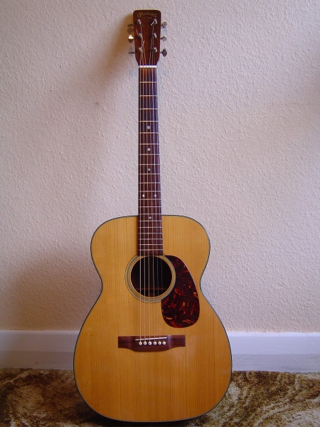

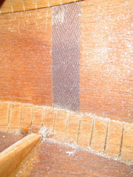

Hesh, here's a couple of pictures of a guitar of mine , a 1963 Martin 00-18, with tape side supports. As you can see this one is more than 40 years old and the tapes (not shellaced) are still perfect.
Incidentally this is my favourite Martin, I think it sounds better than my three 1930s Martins. This one is of course mahogany and has an Adi top, BRW fingerboard and bridge. The top braces are just plain old tapered.

Hesh, I don't know what adhesive was used to stick them on, probably HHG, but they definitely do not have any shellac or anything else put on them afterwards, and they are still well adhered.
It just shows though that, as in all other aspects of luthiery, nothing is new, just gets recycled every now and then.
This is my favourite blues guitar. (Though I might build one of John How's 'Stella' guitars!)

That Martin is an example of twill weave tape. It has a 'selvedge' edge: it won't fray. I suspect it's linen, although it could have been cotton, and stuck on with hide glue. I've seen Martins with tape like that as early as 1918 with no side cracks and the tapes down tight.
The nylon twill tape I tested was not all that much heavier than the cotton-poly bias tape, it was just a lot stronger and less stretchy material, and didn't glue worth a hoot.
The self adhesive stuff Martin used in the 70s was, let's say, less than wonderful. I used to repair a side crack or two on one performer's Martin every time he got back from a tour. The adhesive on the tapes had dried out, and they were just flapping loose, with the stickum picking up dust in the process. After about three or four rounds of fooling with it I removed all the existing tapes, scraped the insides as clean as I could, and put in proper cloth tapes. It took a while, working through the soundhole, but he stopped coming back with side cracks. The steady income was nice, but not having to mess with that stupid problem was nicer.
BTW, I think it's important to run the tape under the liners. Not only does it anchor the tape ends, but it doesn't leave you with a weak eare right at the edge of the liners, where it's really hard to fix a crack.
I shellac after I've put in the liners.

A 'selvedged' edge on cloth is what you get off the loom along the sides. The weft threads hold the last warp thread in, and it won't unravel. That twill weave tape inside the Martin was woven as a narrow strip, so it has selvedged edges. Bias tape is made to fold over and sew onto cut edges of cloth, to keep them from unraveling, so it's a sort of artificial selvedge. It's cut on the bias so it can go around curves without wrinkling. When you get it the bias tape is folded under so there are no loose exposed threads.
